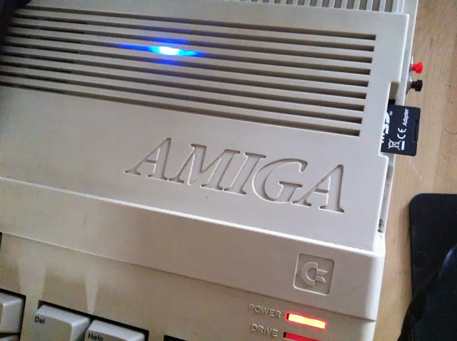

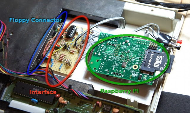

You can put the RPI so you can change/update the SD card without open the Amiga, as you see in the pictures..
The blue led on interface can be easily seen through the case holes without touching the case. As you can see, the interface needs 2 buttons I located in place of the remove disk button: the black one is the "change disk button", when pressed the next virtual floppy disk is inserted in virtual drive, and the red one is to "write to SD button", when pressed it saves all the modified disks on SD. If you push both the buttons, the interface goes in setup mode where you can choose the disk you would like to use.

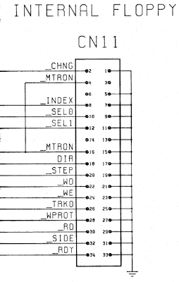

Because the Amiga internal floppy drive connector has only 2 select line, it is not possible to have more than 2 virtual drives without modifying the Amiga, so you can only use the first and the second drive during setup (the others two will be useful with the external version of the interface).

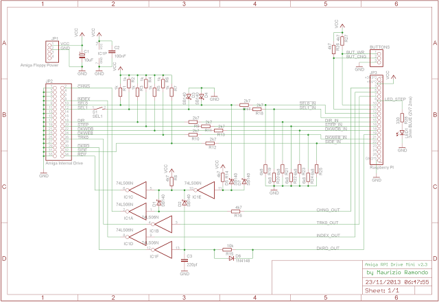

The interface
The schematic:
Partlist
IC1 74LS06
C1 10uF
C2 100nF
C3 220pf
D1-D5/D7 SB140 (*6)
D6 1N4148
R8/R14/R16/R26/R27 4k7 (*5)
R15 10k
R1-R7 1k (*7)
R9-R13/R17/R18 2k7 (*7)
R19-R25 6k8 (*7)
R28 330
LED1 3mm 2.7V 2ma
S1 switch
JP1 Amiga Floppy Power 1X4
JP2 Amiga Internal Drive 2X17
JP3 Raspberry PI 2X13
Basically, for the input lines there are pull-up resistors and voltage dividers to adapt the 5V to the 3V3 of the Raspberry PI. The SEL1 line pass through a switch so we can disable the second drive, needed if you want to attach external drives (for ripping a real floppy disk into adf file in SD).
The outputs go through the 74LS06 containing 6 inverter with open-collector outputs, needed to correctly manage the disk bus. The RDY line is managed directly by the interface and it used to help protecting the bus when there are external drives disabling the CHNG line and the DKRD line (the other lines are managed by software).
The Raspberry PI is powered from the floppy power connection which it is enough for the model A. I tried model B, which require more power, without any problem, but I can't recommend because the maximum power requested in this case (700ma on certain conditions) is more than the power Amiga can provide through the connector (550ma). The interface require Raspberry PI v.2.

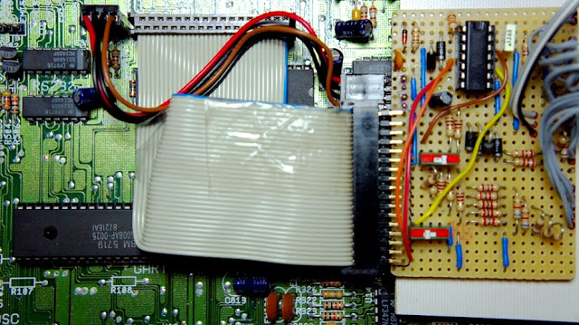

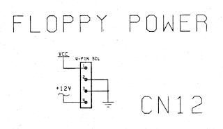

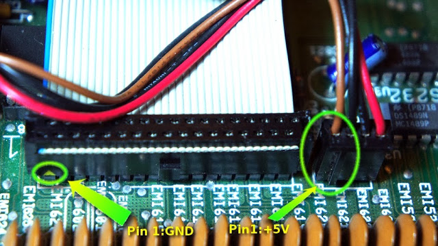

These are the connectors on the Amiga we need to use, probably you would like to use the same cables used by internal floppy disk drives:
In the following image you can see the connectors of my Amiga 500 (rev.5!), I marked the pin 1 of the CN11 (it is the one near the yellow triangle) and the pin1 of the power connection (near the plastic line, 5V cable I have is brown). Be careful, the red cable (pin 4) is 12V and if you swap the cables red and brown (and there is no protection against that) you could damage Amiga and/or Raspberry PI and/or the interface.
Amiga Internal Floppy Connector and Floppy Power
These are the connections between Amiga and the interface:
Amiga RPI Drive Connections

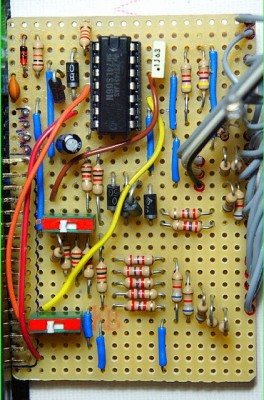

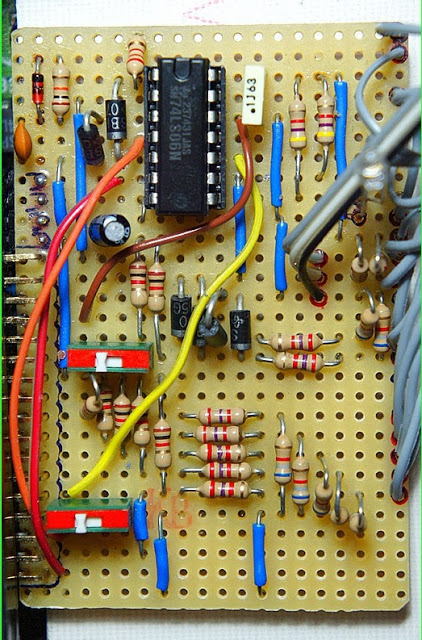

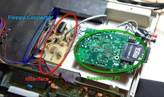

As you can see, for the interface board I didn't made a specific PCB, indeed the circuit is finally so simple I preferred to use a protoboard.
Amiga RPI Drive Interface

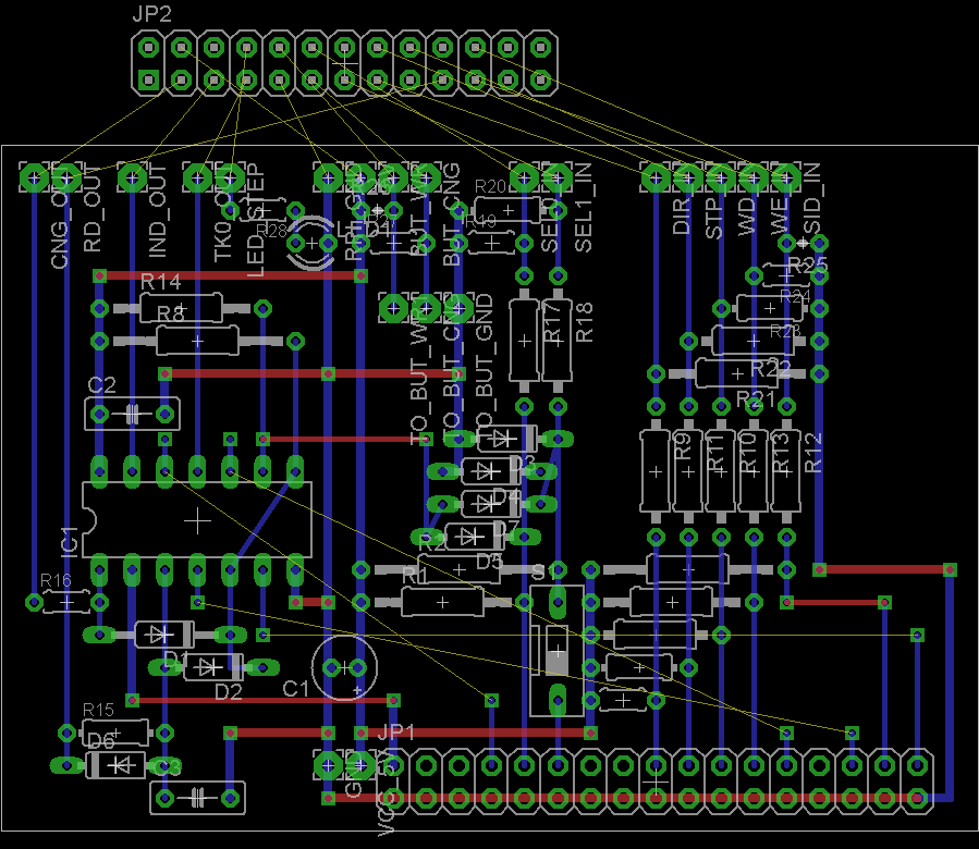

protoboard.zip
(81.33 KiB) Downloaded 716 times
Protoboard
