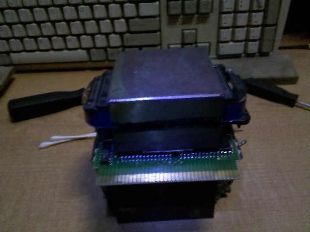

if your planing on doing this mod on an nes cart, please note that there arn't a whole lot of places for a clamp (or whatever your gonna use) to hold on to the circuit board.
[img]C:\Documents%20and%20Settings\Administrator\My%20Documents\clamp.jpg[/img]
this is what i used to secure the circuit board. on the bottom is a transformer from a powerful late '80s
stereo system and on the top is a transformer from an apple imagewritter II printer. if you are only able to hold the board by the chips, please be very careful as to much pressure will damage the chips.

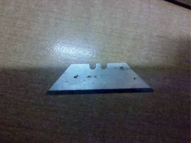

[img]C:\Documents%20and%20Settings\Administrator\My%20Documents\smoothing_tool.jpg[/img]
i found that useing a blade from a utility knife works best fore the job of smoothing the solder.

my imporvised clamp
the smoothing tool i prefer
